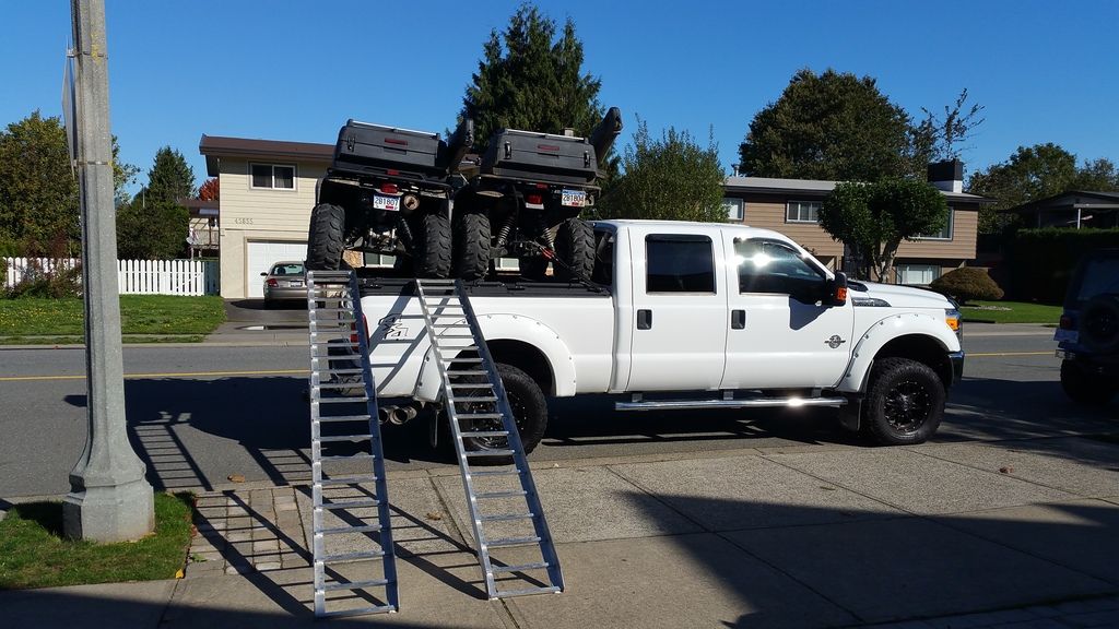

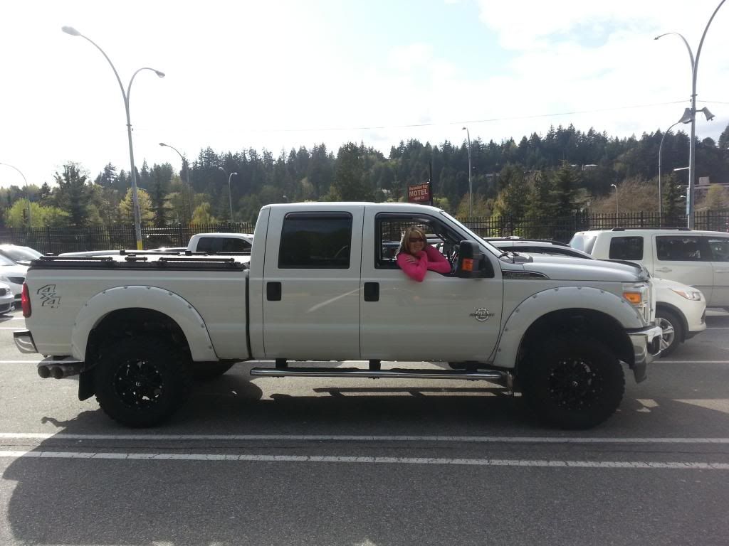

They hold 1600lbs and are a great lockable Tonneau cover when not hauling your machines. I found mine on craiglist for super cheap. Had never been driven on!

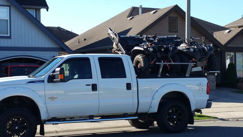

Love this deck, great as a Tonneau Cover when the machines stay home. Can secure , tools, guns etc, just need to lock the tailgate.

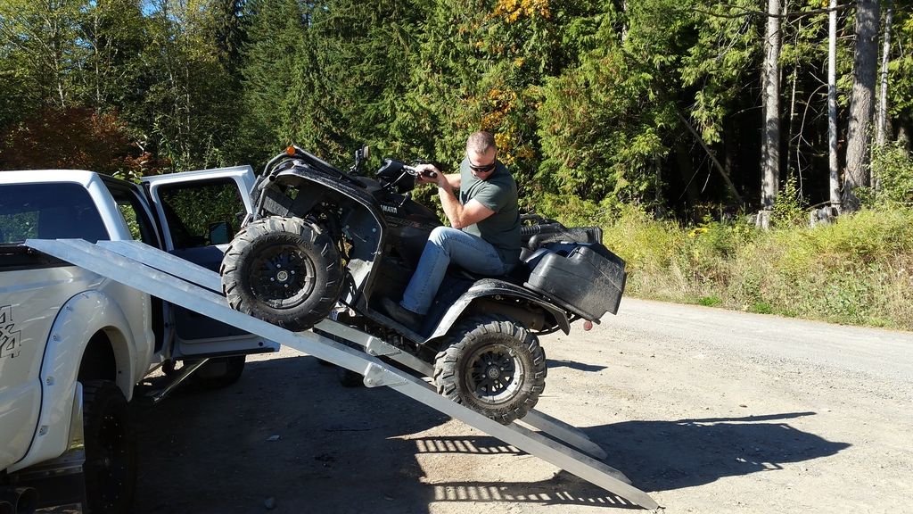

Thanks for re-posting the pictures! Looks like it just perfectly fits your two ATVs. Do you have to back them off the ramp? Looks like you're backing off the bed in the last picture. Or can you set the ramp on the other side of the deck?
Very efficient way to carry all that you need in the bed and to load up your ATV's. Beats having some of the more extreme setups i've seen.

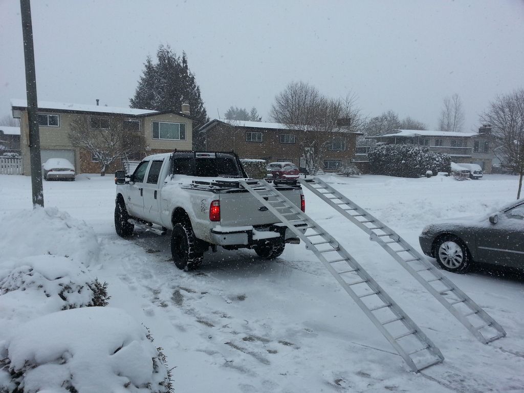

I have to back the quads off. Its not to hard to do, the ramps fold out to 12' long. So they aren't too steep. There is a bar that sits in front of your quads on the far side of the truck, its there to keep you from driving too far forward and off the deck. Therefore you have to back off. You can switch the sides for the ramps depending on what works best for you. When I bought the deck it came set up for a single side by side that end loaded.
I had to buy the parts to convert it to a side loading deck for two quads. Now there is an extension that sits over the rear bumper to allow a second quad on the back of a short box F350. I also had to get rid of the headache rack to fit the second quad on.

Loading from the back looks less steep but if you have to fit two then I guess the only option is to load from the side.

Turning it into a system for 2 was smart, sure beats having to rely on a trailer which is what i've seen some folks had to do, and trailers can be a headache at times, best not to have that to worry about.
The Diamond back deck I have is Line-X on top of checker plate. Its nice getting quads on the truck, cause it allows me to pull a travel trailer and bring the quads.
